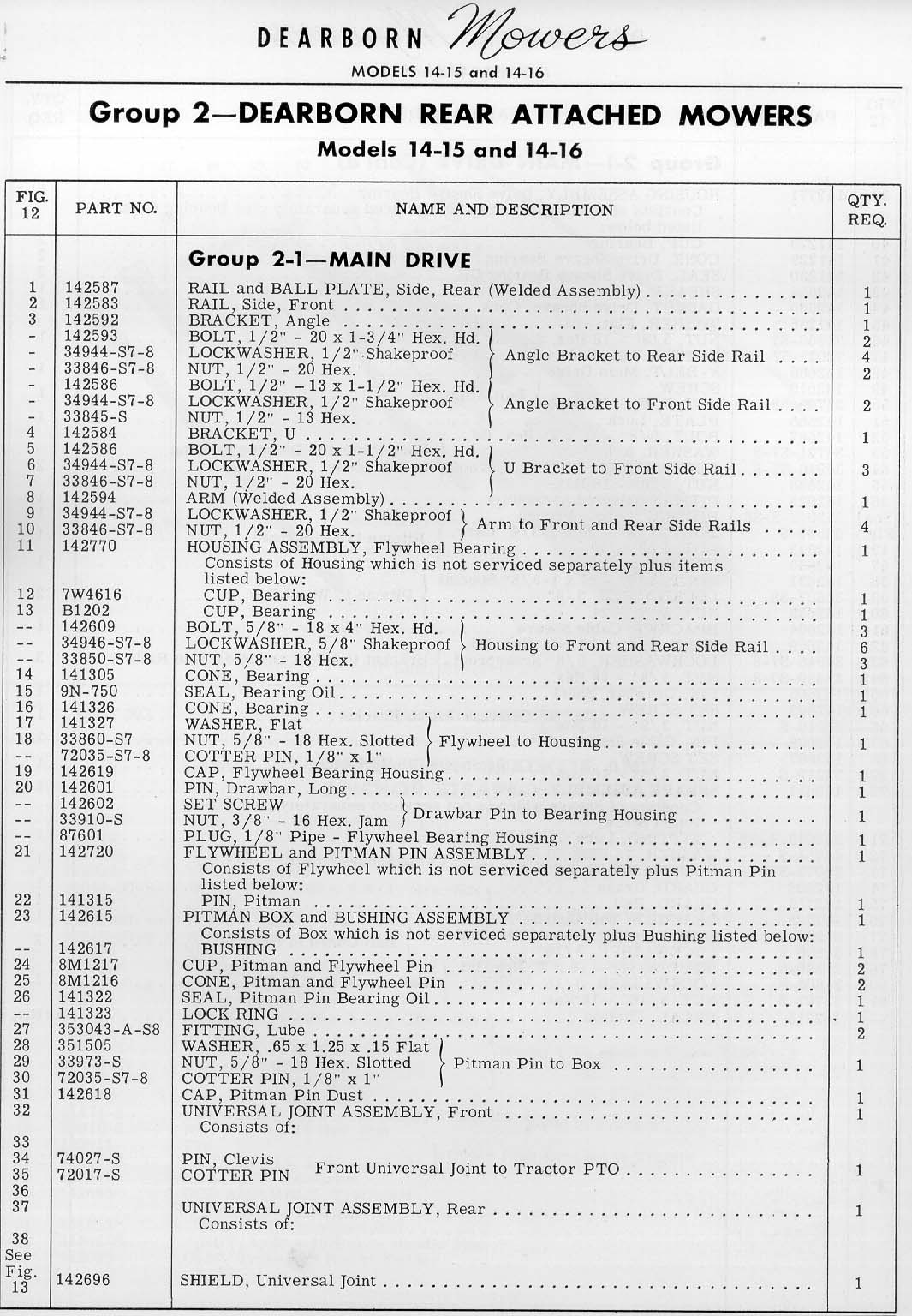

%20Dealer%20Parts%20Manual/page%2002%20-%20main%20drive%20-%20parts%20list.jpg)

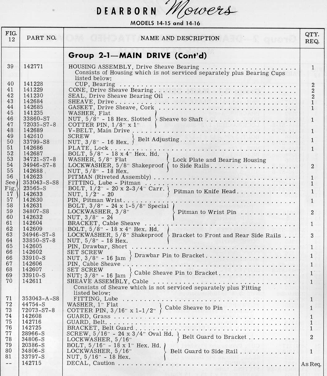

%20Dealer%20Parts%20Manual/page%2003%20-%20main%20drive%20-%20parts%20list-2.jpg)

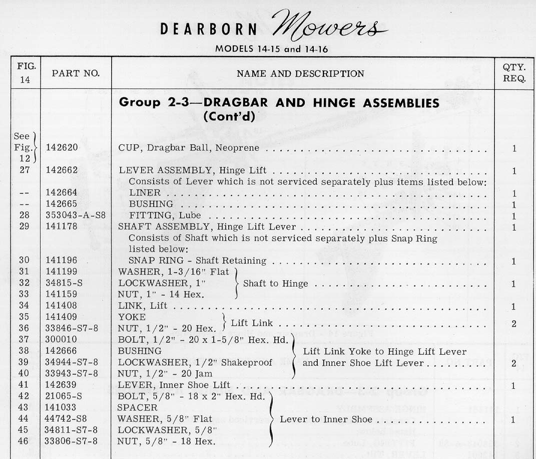

%20Dealer%20Parts%20Manual/page%2006%20-%20dragbar,%20hinge%20assmbly%20-%20parts%20list-2.jpg)

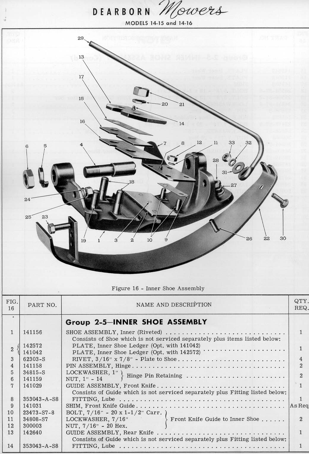

%20Dealer%20Parts%20Manual/page%2009%20-%20inner%20shoe%20assmbly.jpg)

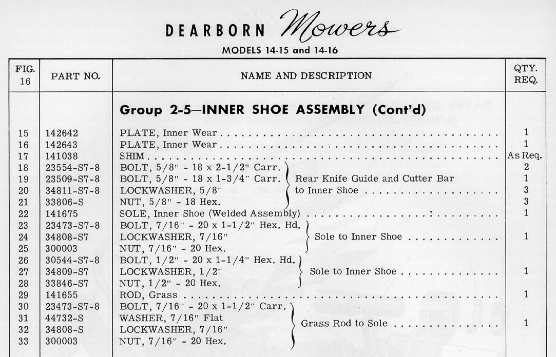

%20Dealer%20Parts%20Manual/page%2010%20-%20inner%20shoe%20assmbly%20-%20parts%20list-2.jpg)

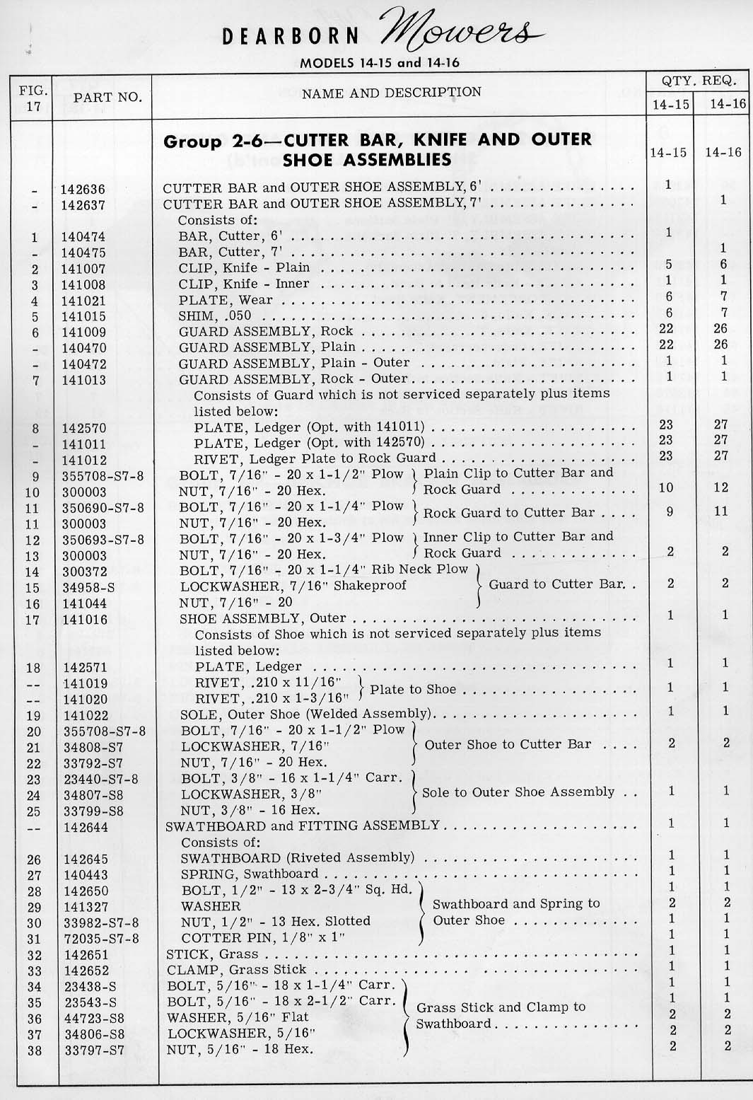

%20Dealer%20Parts%20Manual/page%2012%20-%20cutter%20bar,%20knife,%20outer%20shoe%20assmbly%20-%20parts%20list.jpg)

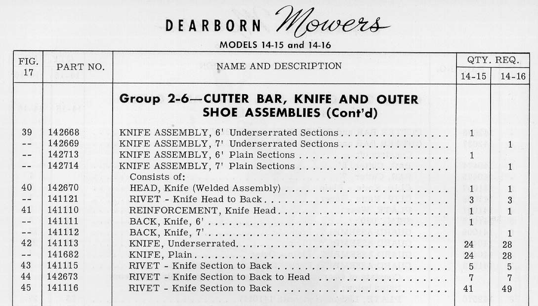

%20Dealer%20Parts%20Manual/page%2013%20-%20cutter%20bar,%20knife,%20outer%20shoe%20assmbly%20-%20parts%20list-2.jpg)
