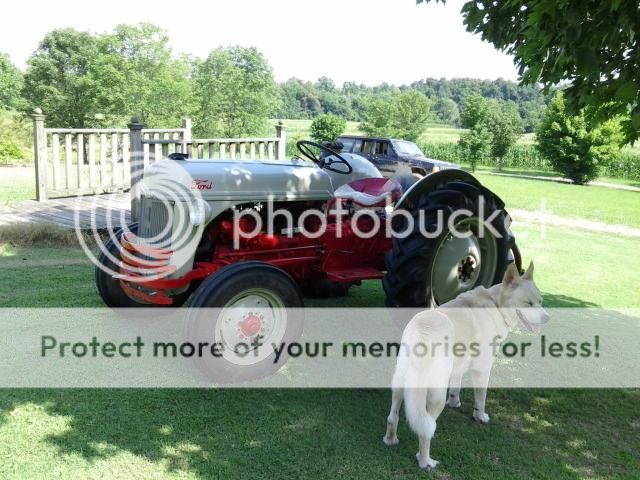

"Woewoe" The 1948 8N
Serial number 8N37762
