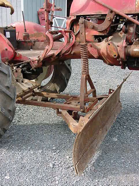

Here is a photo of the grader blade on the cub. It has a little down pressure from the rockshaft. It also pivots on the rear drawbar. It can only be used on the standard cub. The loboy doesn't have the hight for it. The loboy might even be higher then the N tractor. I can measure them since I have serveral cubs if you like. I don't think this application will work for you on the N. As stated probably the best bet is a box blade with scarifiers on it. A little weight to that or your front blade couldn't hurt.
Kirk
