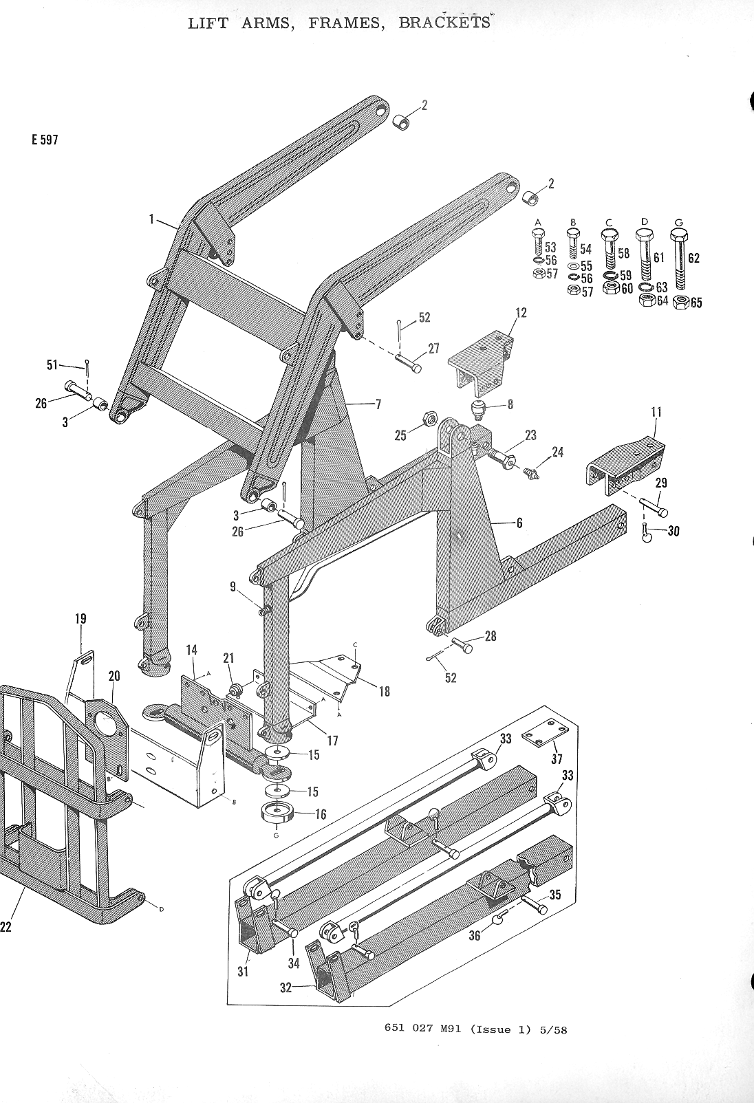

Re: Davis Loader mount?? model 101 or 801??? to fit my 801 ford
Posted by TheOldHokie on January 14, 2013 at 11:55:43 [URL] [DELETE] :
In Reply to: Davis Loader mount?? model 101 or 801??? to fit my 801 ford posted by Adam on January 14, 2013 at 11:38:54:
The parts manual has this picture which sure looks to me like it was designed for an N-series.Item number 14 is the front hanger and 17 and 18 are stiffener plates that appear to bolt to the bell housing.
