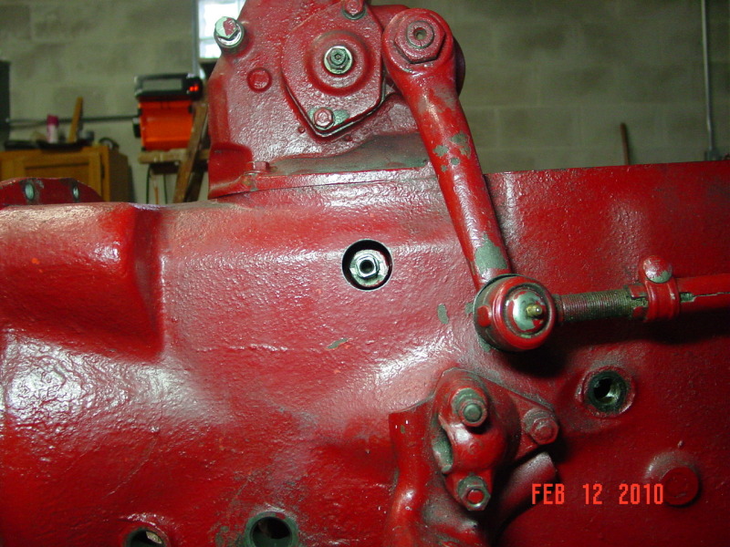

Curt, if it's in the same location as in this photo, there was once a Sherman combo (aka high-low) auxiliary transmission in there that upgraded your Jube to have 12 forward and 3 reverse gears via three gear ranges. A very nice addition that adds value to an N tractor.
